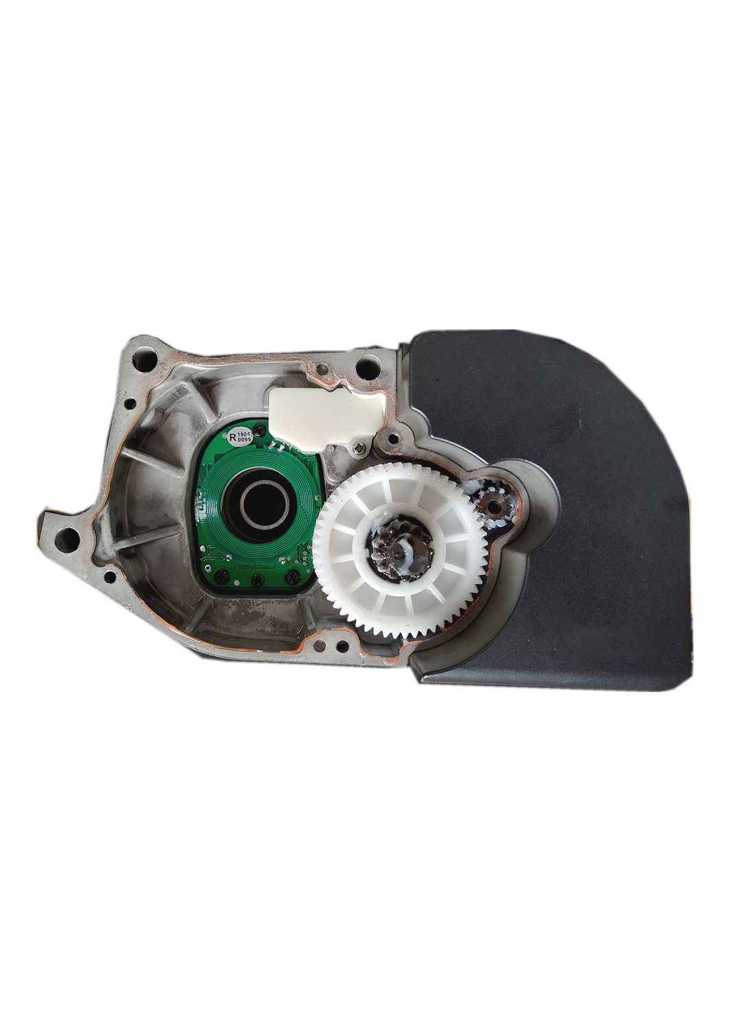

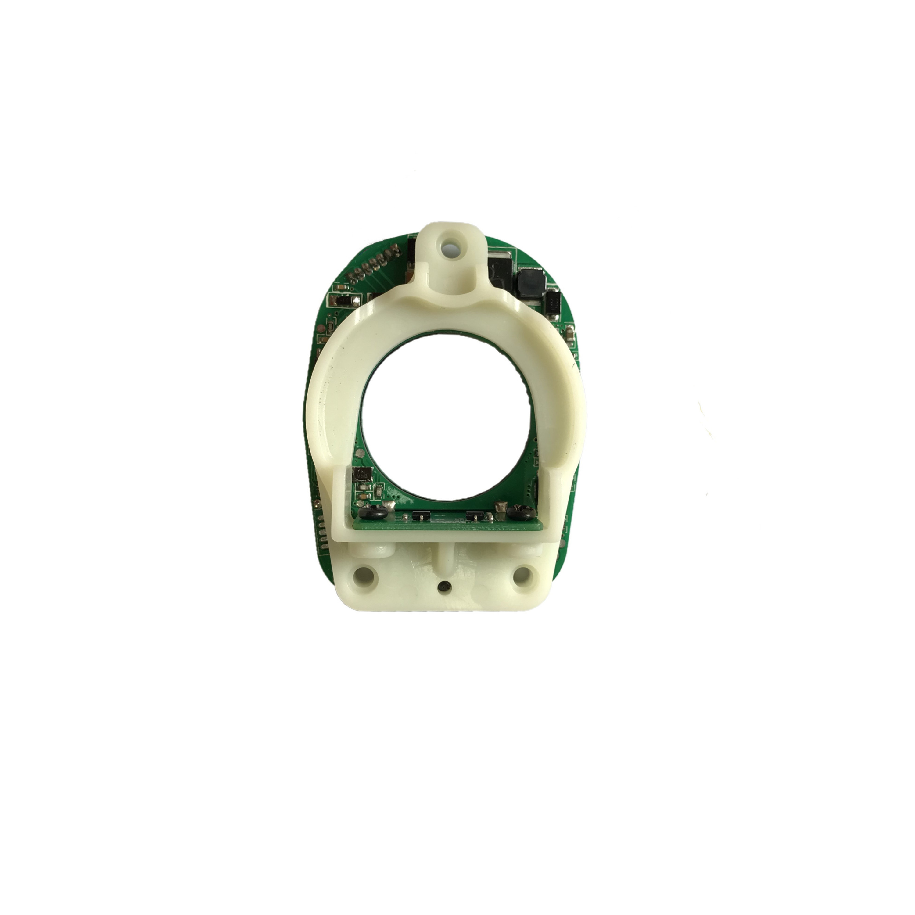

Torque Sensor of Mid Motor
* Low consumption * High speed MCU * Storage calibration * Simulate data * Data transmission * Temperature compensation * Environment dynamic control * Reliable
Items
Parameters
Model No.
LJ_SEN3001
Torque sensor mode
Strain gauge torque rotational coupled transmission
Sensitivity
>16 mV / kg
Min. Detected value
1kg
Max detected value
30kgs
 Deviation (0-2kgs)
0.5kgs
Torque sleeve loading (continuous)
150kgs
Torque sleeve loading (instant)
300kgs
Fatigue cycles
100000 times
Post-fatigue deviation
< 10%
Water-proof
IP56
Input voltage
12-45V
Input current
<0.1A
RPM signal
>32Hz
RPM forward running signal
>3V
<0.5V
Pedaling output benchmark
0.4V
Sensitivity output
1.2-1.7º
Pedaling output signal mode
Analog signal
Pedaling signal delay
<30ms
Pedaling signal transmission
Wireless power carrier mode
Pedaling signal output frequency
200Hz
Pedaling signal frequency range (0-30kg)
50-2000Hz
Pedaling signal drifting (<)
±0.5Hz
